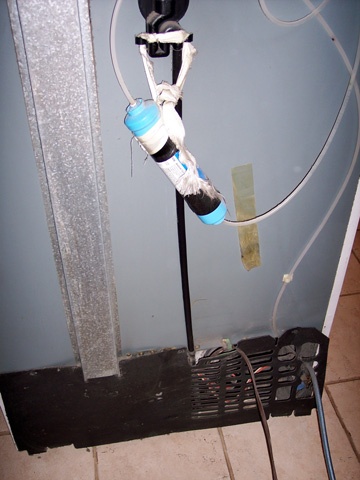

post some pics of the back of that energy sucker.might helpRec rm vm30 micro pro 3000 akai 2 channel. ht anthem MTX 5 channel anthem P2 statement anthem 325, 8 channel Martin Logan power amp for 4 ceiling ls900 2 and outdoor polks, 2 JL 110’s subs panasonic 65" plasma lsim 705’s , 706c, L200 and Control 4 garage rig monitor 10s crossovers by VR3, dynamat, RDO-194's, new drivers. psw 111 Pioneer 9040 BDP53fd 100 " screen Nakamichi HD projector, and Panasonic 65” plasma.

I will post pictures of the recess area and back of the fridge later today -

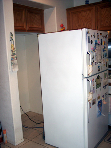

This is what the fridge + recess area looks like:

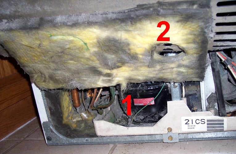

The noise is coming from the bottom, which is where the fan and compressor are located:
- Compressor
- Stock dampening material
Is there a special dampening material for refrigerators or am I good just replacing it with something like dynamat? I'm thinking of doing this for both the compressor and the fan. If that's still not enough, I may cover the wall behind the fridge in the recess area with a couple of layers of #30 roofing felt. -

Time for a refridgerator upgrade if you ask me.
Here are some isolators designed just for appliances, made of Sorbothane.
http://www.vibrationsolution.com/onlinestore.html
+100 on unplugging it....hehe but I get that is only short term.
How about some Black Hole Isolation sheets only the back wall?
Also add some better isolators on the compressor. -

sounds like the compressor is making the noise..
make sure everything including all lines are strapped down and tight
freon may be low, that would make the pump work harder

If you have enough clearance behind your fridge, I'd order a panel,(or make one) and give it a shot. -
It's pretty tight back there so a 2" thick panel is not a realistic solution for me. But if the Silent Feet is not good enough by itself I may stick several layers of Fat Mat/roofing felt/B-Quiet/eDead/etc. on the wall directly behind the compressor and fan to absorb the noise.

You can add more sound damping matteral to where it is now. Do not block off condenser fan air inlet.(bottem right from the back).For all reading this thread, dust bunnies on condensers=money out the window,and premature death to compressors.Long live the dust bunny the refrig guy says$$$$.Rec rm vm30 micro pro 3000 akai 2 channel. ht anthem MTX 5 channel anthem P2 statement anthem 325, 8 channel Martin Logan power amp for 4 ceiling ls900 2 and outdoor polks, 2 JL 110’s subs panasonic 65" plasma lsim 705’s , 706c, L200 and Control 4 garage rig monitor 10s crossovers by VR3, dynamat, RDO-194's, new drivers. psw 111 Pioneer 9040 BDP53fd 100 " screen Nakamichi HD projector, and Panasonic 65” plasma.
