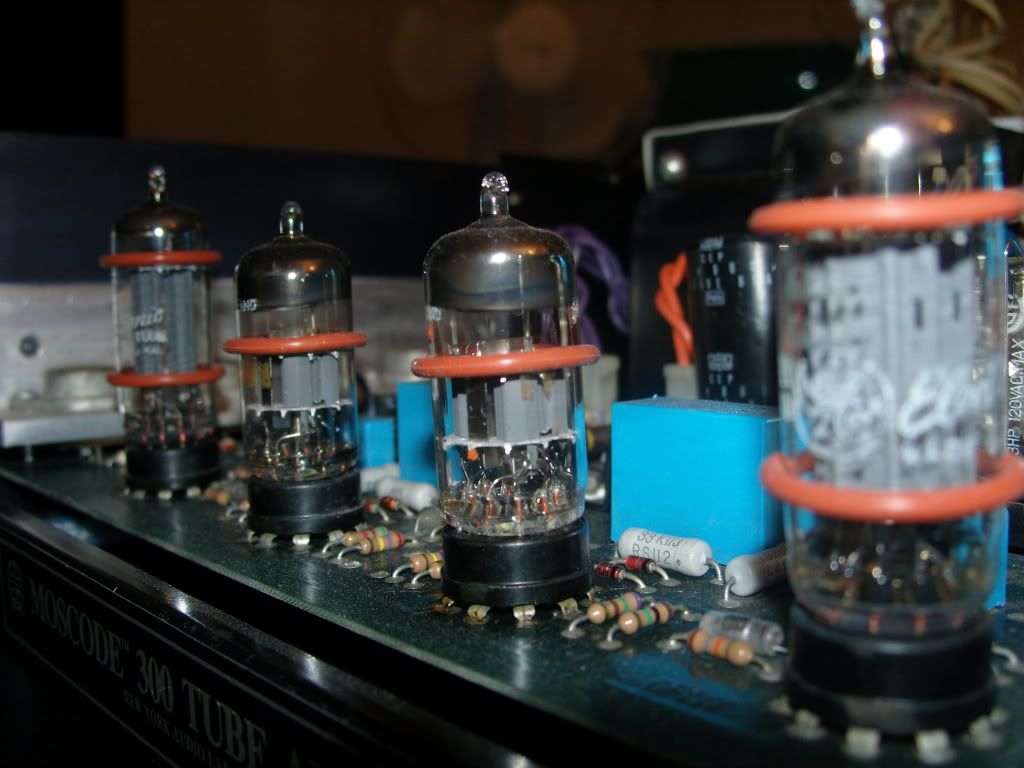

Posted this pic in the "Show us your guts" thread but in case no one's seen it here it is:
Upgrades include some caps added, internal wiring upgraded to monster wire, upgraded binding posts and a now removable IEC cord. I didn't do the mods, friend whom I purchased it from did :D
Current tubes are some Electro something (will double check later) if I read correctly, and I guess the red rings around the tubes are tube dampers.

    It would be helpful if you could tell us what the tube types are. Not the brand, the type.
    That amp is a hybrid with SS outputs, so unless I'm mistaken the tubes do not require biasing.

    SS amps need biasing too.
    Looking at your picture, those 4 tubes appear to be 9 pin signal tubes, not power tubes and therefore cannot be biased.

    IIRC the unmodded Moscode used a pair of 6DJ8 and a pair of 6FQ7's,,, the modded versions had the caps and other parts upgraded,and the tube compliment was 4 6FQ7's.I used to have a box of 6FQ7's,,if you are interested,I'll look around and see if I have any left.It would be nice to know what mods were performed,as I've only owned one tube hybird,and the tubes did not have to be biased.YMMV--good luck.
    F1nut Posts: 51,022
    edited October 2009
    I found this, http://moscode.home.att.net/Parts.html#anchor3135262
    George is right on the money. :)

    Ha sweet, I got those numbers for the outside pair of 'larger' tubes. 6FQ7 and underneath that it says 6CG7. Electronica tubes from Holland.
    The smaller inside pair is a bit hard to read but it says 6DJ8/E?C88.
    I should've specified it's 1 mod, and like 3 upgrades. I'll post a close-up detailed pic. I should've made note of what was inside the amp when I had taken pics but now I've got them, thanks guys. :D

    Here's the tubes
    And here's the mod (Dayton's up above). The upgrades are; new binding posts, now-removable IEC cord, and monster wire from the posts straight to the board.

    Ok, the 6FQ7/6CG7's are GE labeled, but likely made by Philips or perhaps Amprex since you say they are marked Holland. Those are probably the "best" ones you'll find for that tube type. It appears that the 6DJ8/ECC88's are Electro-Harmonix's, you can do better.
    BTW, keep an eye on that Monster cable as it tends to turn green/oxidize, which is not good.
    Ok, so that narrows it down to going through only 1 pair of tubes. You answered this earlier but I just want to make sure since I'm stepping into a world I have no knowledge of. Biasing this thing is strictly the SS portion of this thing, so if I switched out tubes there's nothing required of me to do right?
    Well, I did say that the 6FQ7/6CG7's are probably the best, not that they are absolutely the best.
    Correct.
