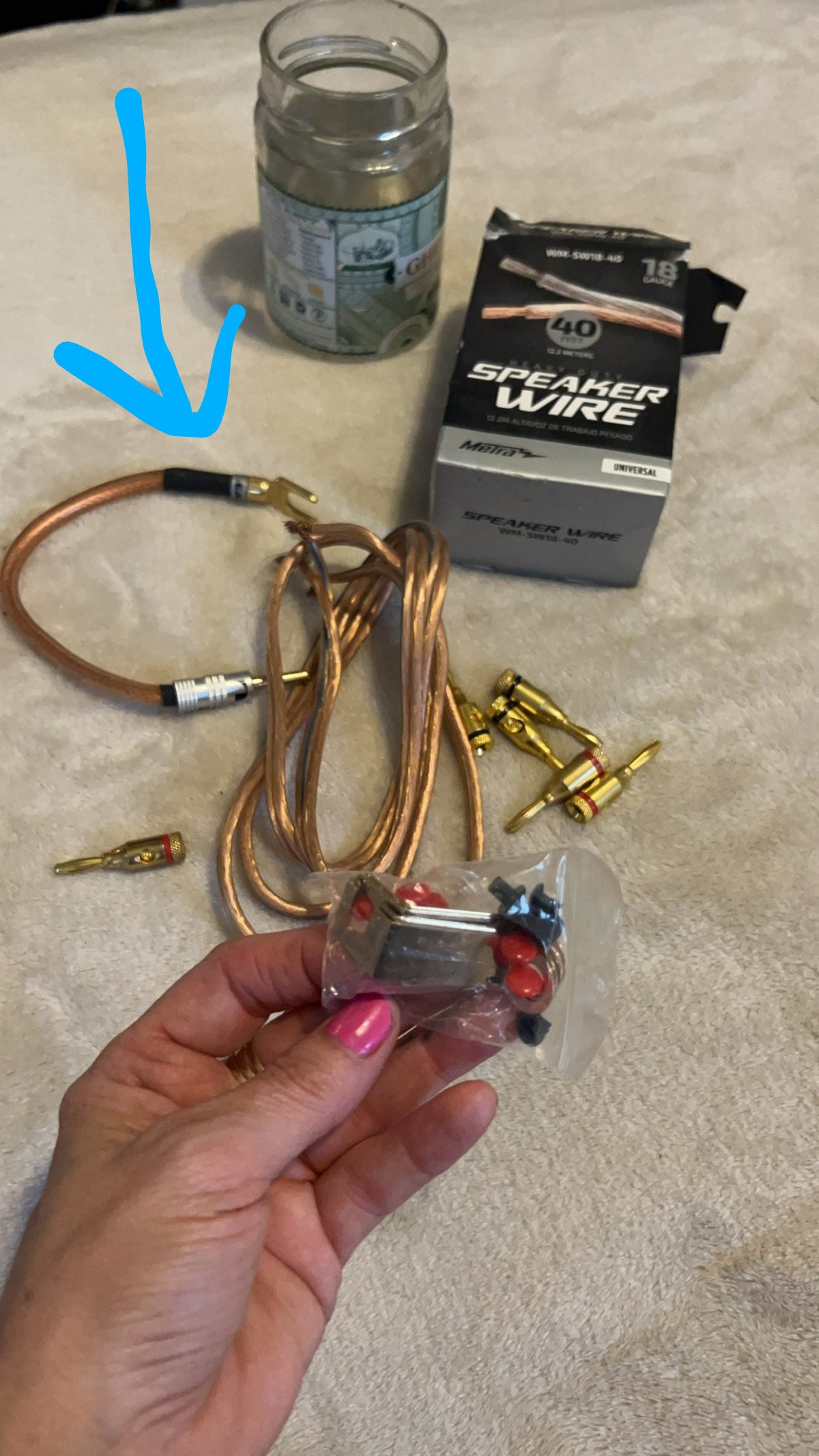

    So on one channel we're using the gold as positive, silver as negative, and on the other it's reversed? That's not confusing at all.
    Then we got dual blue wires with seemingly no polarity markings for the surrounds/bookies. Interesting.
    I guess technically it doesn't matter if the polarity is reversed, they'll still make sound, but meh. Would be nice to correctly do it positive to positive, negative to negative.

    Thank you steve just tried the tape trick and it worked, that's been bugging me for a while!

    Thanks for pointing that out clip... my eyes aren't the best.
    With the blues I did try them each way to see where the sound was clear I noticed if they backwards it's somewhat muffled. I'm not knowledgeable on this stuff so not to sure about the technical aspect or "polarity" reference. Sorry 🤷🏻‍♀️
    Clipdat Posts: 13,101
    edited April 2025
    It just means that on both the back of the receiver and the rear of the speakers, to connect red (positive) to red, black (negative) to black. But it's tricky when the wires aren't clearly labeled, as in this case.
    It sounds like you already experimented though and got everything connected properly now. Also no need to apologize, this stuff is difficult to explain in text over the internet.

    Thanks for the vids, I was looking at the other ones and then they disappeared but I will look into it on YouTube. For now they sound good but I'm going to swap the red & silver around to see if I get a difference since i seen in the pic you sent it said silver to red. I just figured red to red. Most of the bass comes from the S15.
    F1nut Posts: 52,182
    This isn't hard. Connect the + from the receiver to the + on the speaker. After that it'll should be obvious where the other speaker cable goes. It doesn't matter what the color of the cable is as long as it's + to + and - to -.
