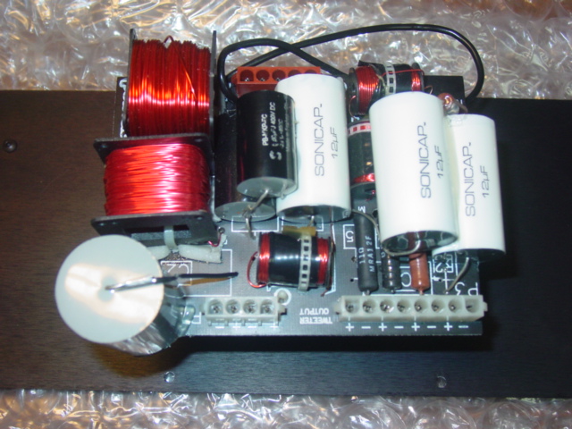

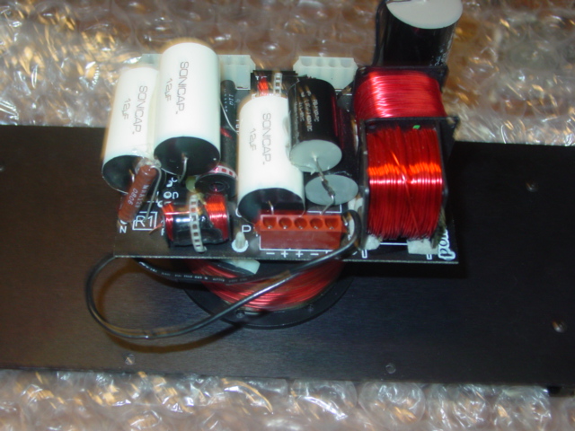

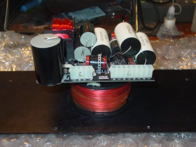

    Here are the pictures of the crossover. Are those the original coils? I also see that the sealing was not done very well in the upper right corner. I was not impressed with the bass and that may be one reason why. Will check the other crossover later. That caps are Solen and Sonicap. The resitors are Mills (USA) "love those old black ones" Too bad Vishay closed down the plant in Ill. and moved to Mexico.
    Toolfan66 Posts: 17,982
    edited February 2014
    Yep, those are the ones Ben upgraded for me, when I first got into the game of SDA's.
    Not impressed with the bass? What are you powering these with? I never had any issue with bass with those crossovers, and I doubt that corner would have a drastic impact with the bass..

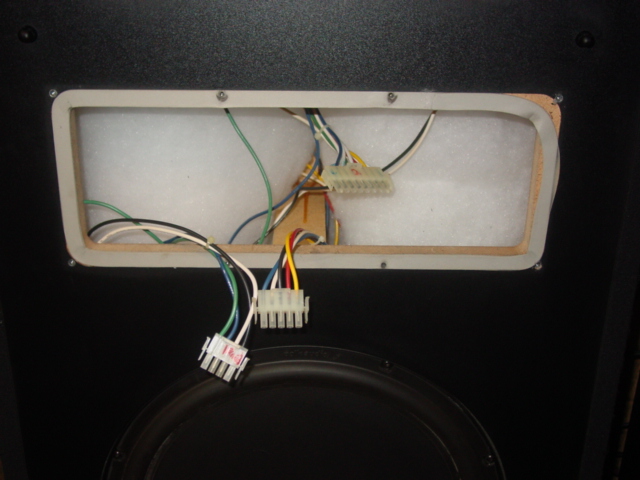

    OP,I just read that there's not supposed to be insulation below the lower-most mids. In your last picture, it clearly shows insulation behind, and extending BELOW the x/o's. Could this be the cause of the lack of bass?
  • embrown057
    embrown057 Posts: 46
    I resealed the crossover on one speaker and moved the poly fill up to the top of the cabinet as suggested by "drumiv and low and behold the mid-range cleared up and the bass is now more defined. I still would like to know if by the picture I posted anyone can tell me if the small inductors are the originals. I also would like to know if there is a "official" white paper from Polk on the 1.2 to 1.2TL upgrade. Has anyone documented the entirety of the upgrade? I got that F1 did not do this crossover upgrade but I have no idea who Ben is or how I can contact him to see if he may remember what he did if anything to the inductors.
    F1nut Posts: 51,673
    Those are the original inductors.
