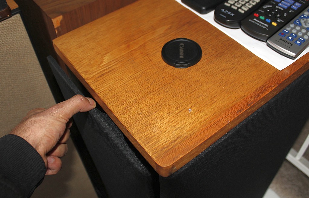

Side panel on my SDA-2B's are little bit un-glued on top and some corners.
Is Elmer's wood glue is good option?
I also have another brand's 'Stronger than wood' glue.
Or should I use hot glue?
Thanks for suggestions.
    It's not split.
    It just came un-glued on top and some sides.
    Here is a pic of what I'm talking about:
  • michael1947
    michael1947 Posts: 775
    edited January 2013
    I see and it look to be the fabric and then the fabric covered panel to the case of the speaker. Hot glue may now be my choice as it is usually removable and will stick to anything but it is very fast so be prepared with the little spring clamps for the fabric and once it sets do a dry run on clamping the repaired panel back onto the case. You may be able to turn the speaker on its side/back,use a little piece of wood and weight it down with a 12 pack or something.:razz:

    My SDA1C were like that and the fabric was coming loose. I used regular old wood glue.
    I pulled the panel completly off with 4" wide putty knife ( slowly do not bend or tweak) glued the fabric back down used a bunch of binder clips to hold the fabric till dry then glued the panel back on and got some phone books for weight.

    I used Liquid Nails Heavy Duty Construction Adhesive... out of a caulk type gun. And LOTS of weight overnight. But my project was an extreme makeover in which the entire side panels, the fabric and the wood, both came off.
    http://www.polkaudio.com/forums/showthread.php?138538-SDA-SRS-2-need-CPR-and-ICU-life-support
    If its releasing that easy, instead of trying to force a little bit of glue in at the top, and likely making a mess, can you remove the entire panel, scrape it clean of any old glue and glue it right with fresh glue all around? Otherwise you're going to end up with new glue on the top 10% and 25 year old glue on the other 90% that will fail...when?
    If you do think about this route, listen to Polkieman...he knows! Make sure you can get the entire panel off in one piece, without breaking it. Otherwise you'll be making a new panel out of new wood, covered, etc. Been there done that... added a few extras days I wasn't planning on. Pics of fiasco at link above.
    Good luck!

    It's only unglued on top 1 foot or so and I think trying to take the panel off is too risky.
    I'll try to squeeze glue to as much surface as I can so that top portion sticks to the cabinet.
    Bottom part is solid and I'll do more harm prying it off. :confused:

    Yes, the panels break pretty easy coming off. Don't chance it if its not coming off in multiple places.
    When gluing just a portion then, it'd be a shame to get glue on the fabric. I'd insert the edge of a large piece of paper (full width of panel) about an inch in between panel and speaker, and leave most of it hanging out, and fold it over the fabric. Then apply the glue behind the paper, so that the paper is shielding the fabric. Then take a piece of heavier stock paper (but still bendable) like a business card, and use it as a tool to force the glue as far down as you can. Then finally remove the paper barrier last before pressing together and apply LOTS of weight overnight. Good luck!

    Yea get you a 12 thin plastic ruler hold it up a bit with a plastic putty knife or the kitchen spatula put glue on the ruler and side it in as far as you can then let it down as you pull the ruler out .

    Use blue tape to protect the fabric work quickly with the hot glue as it sets fast, just keep steady pressure on it for a minute or two. Wood glue can be runny and messy and almost never cleans completely out of fabric.

    I'm rebuilding a set of sda2. I pulled the side covers and cut some new ones and covered the outsides with cloth. I sanded the glue off the vinyl and am ready to glue them back on. I see Proffitt says he used liquid nails heavy duty but I'm second guessing that as I read the tube. It says "not recommended for plastics and vinyl". I see this thread is quite old at this point. I'm wondering if there is now a better glue for the job?
    F1nut Posts: 52,151
    Use Liquid Nails Polyurethane 10 oz. Tan Interior and Exterior Construction Adhesive. It is rated for plastics and vinyl.
    I did see that while I was googling different liquid nails. I didnt see it at my home depot, hopefully they have it and I just missed it.
    F1nut Posts: 52,151
    Amazon has it. https://www.amazon.com/Liquid-Nails-Polyurethane-Construction-Adhesive/dp/B01MPX8U8L?source=ps-sl-shoppingads-lpcontext&ref_=fplfs&psc=1&smid=A2ENTBEZKGXKVW&gQT=1
