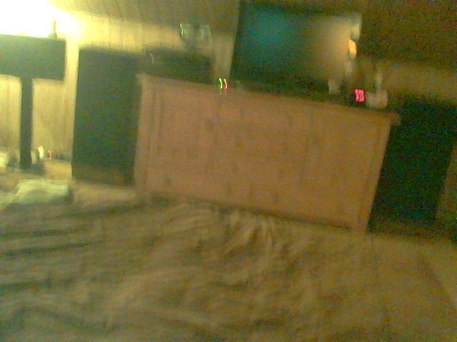

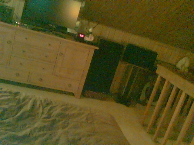

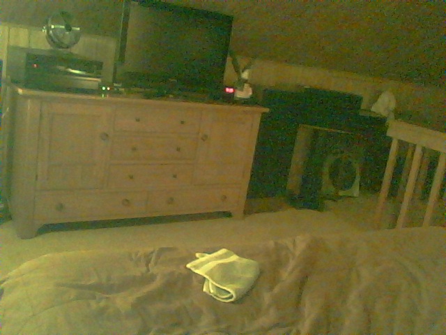

Man O Man. Talk about knocking my but in the dirt! The CRS+ set arrived today and I hooked them up to the Onkyo SR805 as Left/Right surround channels, set the speaker calibration the same as on the 2B's and talk about a quality life like sound. They absolutely compliment one another. I have another member coming over soon to hear the impact the CRS+'s bring to the party, as he already has the 2B's in action. Can't wait to hear his take!!! It may not be everyone's cup of tea, but it is mine and I'm drinking it all up. The combo is all that and 2.....yes 2 bags of your favorite chips. :wink:

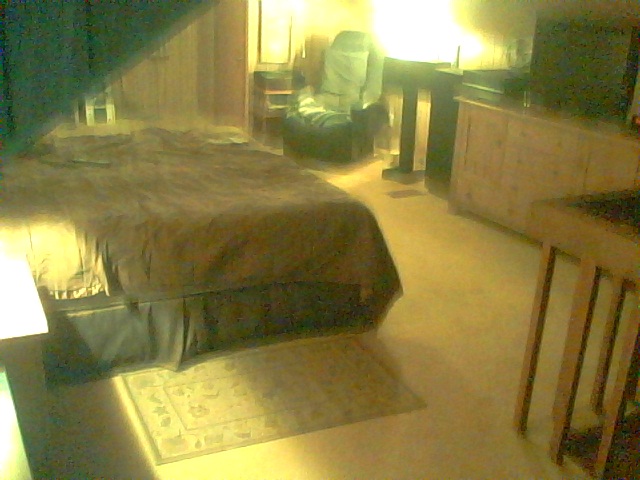

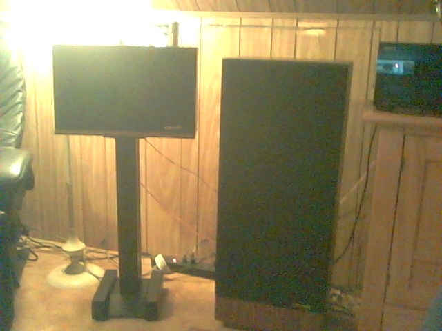

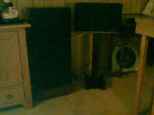

    Bedroom is quite big and that old school ibe just comes to life with this set up. So real and live sounding. I will have the quality cables installed tomorrow and it will be clean looking to go along with the clean sounds. Wife must have bad ears too, as well as my neighbor and 25 year old son, as thy all were blowen away. Don't listen to any nut jobs, try it for yourself. Here to tell ya, it is awesome. I'm sure you'll hear from another Ohio member to the same effect here soon!! Loving it!!! Oh yeah, welcome to my bedroom!!

    After looking at the pics, this has to be some kind of joke? Surround speakers up front, two sets of SDA's run off a receiver, neither pair close to being positioned properly for proper SDA playback and the OP thinks it's the seconds coming??? Where's the PUNK'D crew?
    That said, if for some twisted reason you think this sounds good................that is all that matters, but you have no idea what you are missing, and stop trying to convince those of us who know that set-up is less than ideal it's some kind of aural nirvana.........I don't think so.

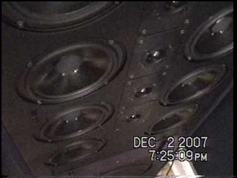

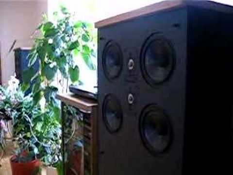

    CRS+'s Toed in at an angle?, Attic room with 45 degree ceiling. All bad sound there. It sounds better because you're finally using good speakers.
    The SDAs need to be set up a certain way.

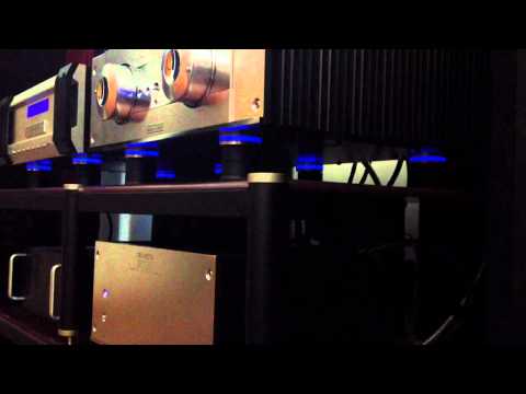

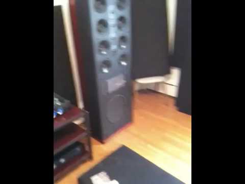

    Too bad you're not closer or you could come and listen to mine:
    (any distortion you hear is because my 12 cent mic in my iphone cannot handle the sound pressure from 600 watts per channel)
    [video=youtube_share;rHHLKERU0wo]http://youtu.be/rHHLKERU0wo[/video]
    [video=youtube_share;AqCf6tHrQIk]http://youtu.be/AqCf6tHrQIk[/video]
    [video=youtube_share;1x1Qa-G3ZaY]http://youtu.be/1x1Qa-G3ZaY[/video]
    [video=youtube_share;SNs6-cpE42g]http://youtu.be/SNs6-cpE42g[/video]
    [video=youtube_share;_JdA4349VEQ]http://youtu.be/_JdA4349VEQ[/video]
    sweet set up you have there and yes, I am now using good speakers. I am not fooling myself, there are much higher end speakers out there, and I could go broke chasing my tail, like so many people do, guess what, I caught my tail. I love it. Listening to the system right now, and wow is all I have to say. I'd love to hear that crazy cool set up you have there.

    Glad you're enjoying what you're hearing, but there is simply no way that having a dimensional driver to the outside of a stereo driver, which is what you're doing with two SDA's side-by-side, could produce a proper SDA sound. There's a reason why Polk designed the speakers as they did, with stereo drivers on the outside and dimensional drivers on the inside. And as you move up the SDA line, you always see two drivers side by side, but the bigger the speaker, the taller it gets, with columns of dimensional and columns of stereo drivers. More power to you in your search for better and better sound, that's what this hobby is all about. But you need to get a basic understanding of the science behind these speakers, and then you'd understand why what you're doing doesn't make sense. If you want better sound, you would be so much better off with a bigger pair of SDA's, than trying to run two pairs side by side.
    Initially, I was thinking CRS+ were used as surrounds without IC cable that may work quite well.
    If it sounds good, then it's good.
    I didn't post this to comment on the setup but the pictures; man those awful cellphone pictures gave me headache.
    No offense but just horrible pictures.

    Johnny - why isn't your TV centered between your 2Bs? :question:

    Okay.......this F1nut knows his stuff, and after unhooking the 2B's and listening to just the CRS+'s I am a believer. Sorry that it took me a while to get it, but I am not the best at it. Sure the combo was cool, but nowhere near as cool as listening to the CRS+'s by themselves. My deepest apology to F1nut and to all that I may have offended. I am not here to pass judgements nor offend anyone in a public manor. I'll end with.. it is good as a combo, but better as singles!! Love it either way.......speaker config that is!!:lol:
