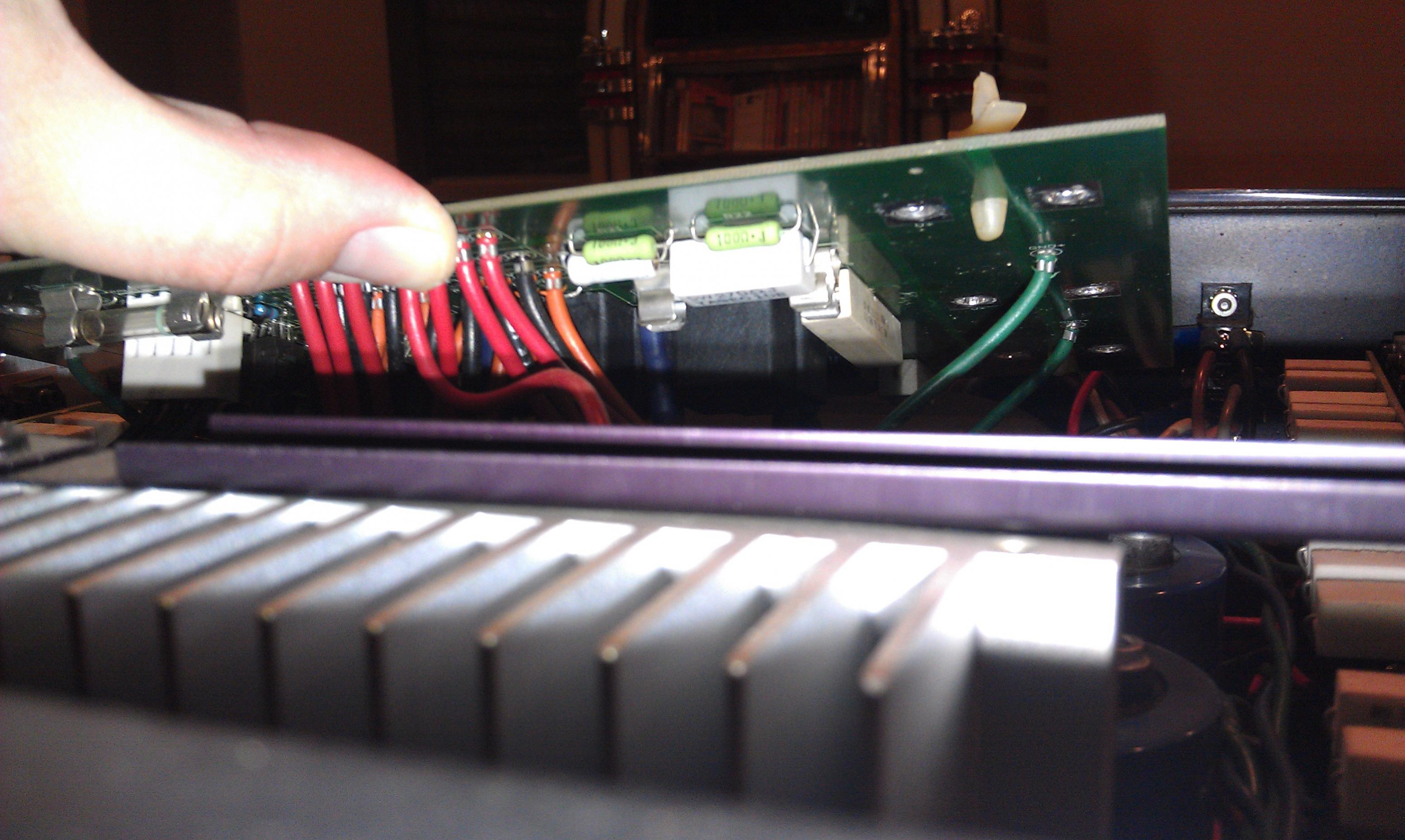

So I just got a used B&K 7270 that was working fine. I had tested it briefly and left it alone on the carpet. Well, my wife noticed a strange smell coming from the basement, and I found my amp idling on. I don't know if I left it on or if the kids turned it on. The problem is that on carpet there is no airflow. The thing was HOT. So, I shut it off, and then (curiosity killed the cat) turned it back on to make sure everything was ok. As soon as I connected the cd player, there was a puff of smoke, and the red light faded away.
So, I cool it down, take the cover off, test all the caps to make sure they are dead with a multimeter, and start exploring to see what happened. I found a tell tale mark of one of the resistors overheating, and the inrush fuse is blown. I replace the fuse, and briefly turn it back on and I notice one of the caps is smoking. Shut it back down, and now I am perplexed. The caps look fine (no bulging or leaking) but there is that resistor. . . Is it possible that the resistor is causing one of the caps to act up, or am I in over my head? I could easily solder it out and find a new one to replace it, or am I screwed?

The first picture is the overheat mark, the second is underneath. The resistor in question is the white one behind the little green ones.

Yeah, one of the big blue ones was smoking on the very top.

I'm looking at the thermal protection in your picture, it's called a fuse. The secondary thermal protection are the heat sinks and it sounds like you created the condition that blew it up. I'd send it back to Eastern Elite A/V not some generic shop. It's basically the old service department from B&K. George is the guy you want to talk to there.CTC BBQ Amplifier, Sonic Frontiers Line3 Pre-Amplifier and Wadia 581 SACD player. Speakers? Always changing but for now, Mission Argonauts I picked up for $50 bucks, mint.
