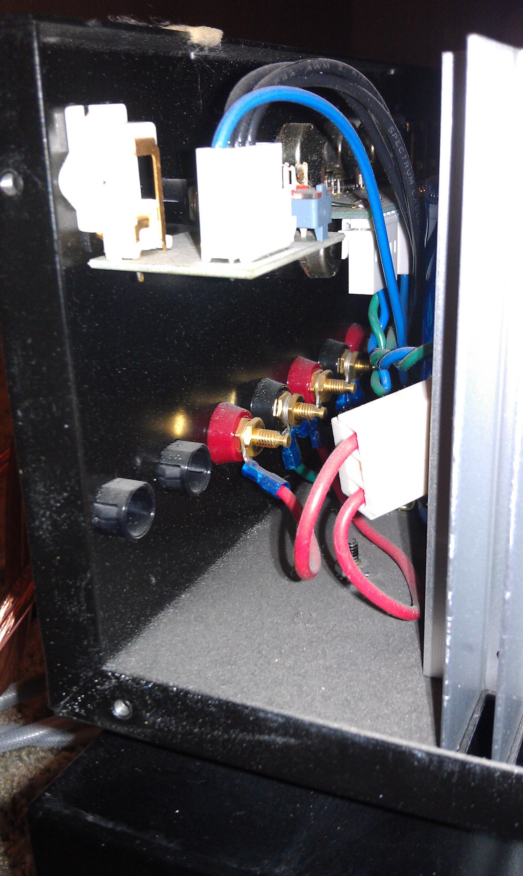

Any ideas on how to get a new speaker terminal for this amp? What if I soldered my speaker cable to what's left of the terminal?

    Just pick up some binders from www.vampirewire.com. You'll have to pop the top on the amplifier and see what kind of chassis mount they use. Depending on that issue, you may or may not be able to DIY. B&K does sell the parts....well, used to before they went under then resurfaced.
    I wouldn't suggest soldering the wire directly to the broken terminal, ever. There's no need to hardwire an amplifier in that way.

    Thanks guys, vampirewire has similar looking posts, but not sure which one exactly. I'll get ahold of B&K and see what they say. It does seem to be a generic binding post.

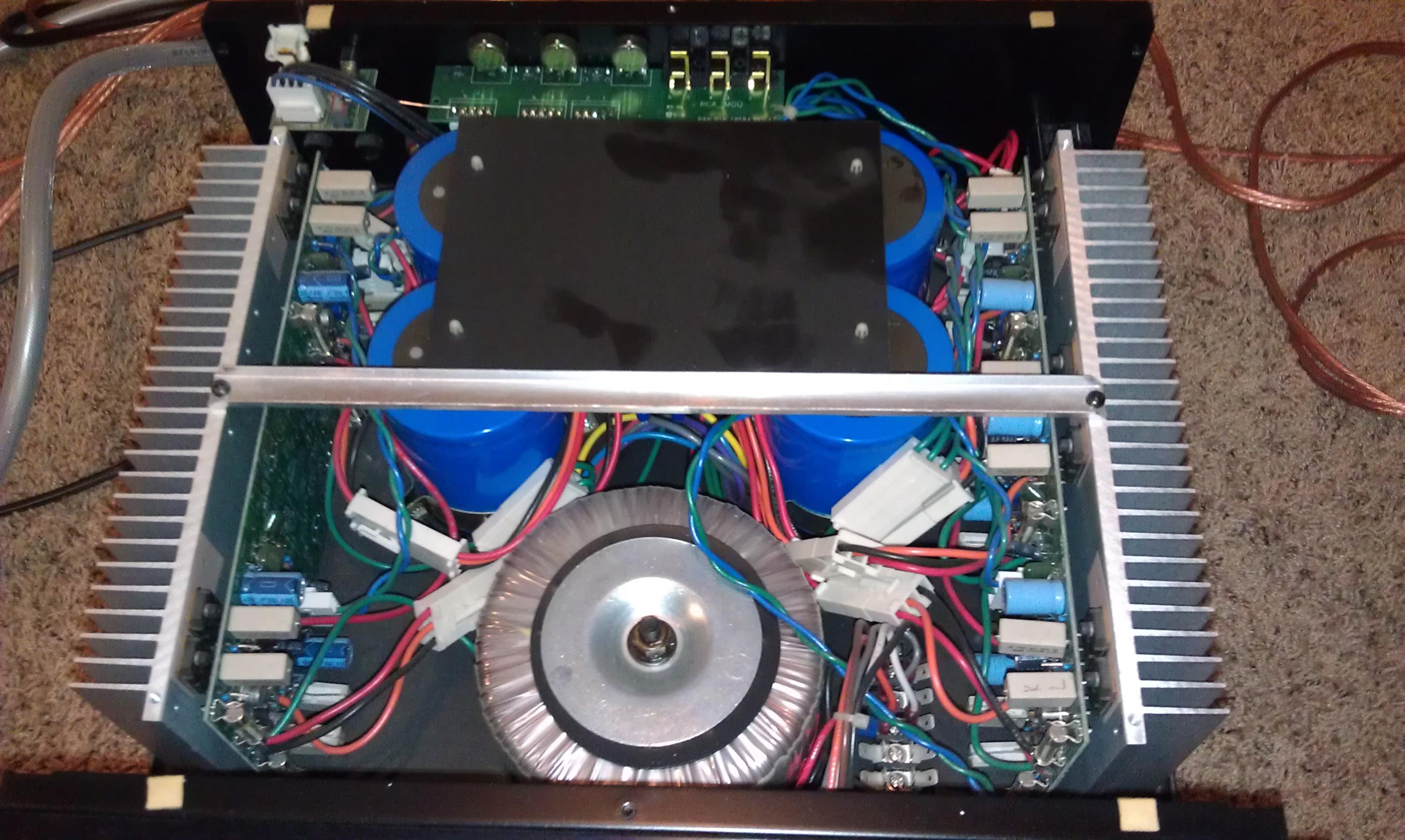

    Lucky it is a diy project. Pulled out the broken terminal tonight, and found one at Antique Electronic Supply that looks identical. Here are a couple of pictures of what I found under the hood of the B&K AV5000. Thanks again for the suggestions and help!
