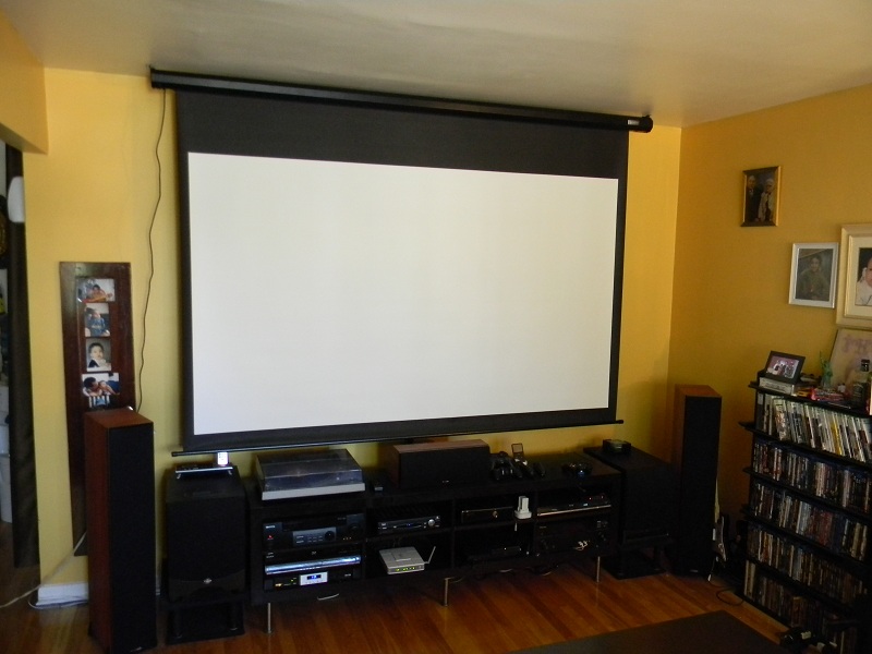

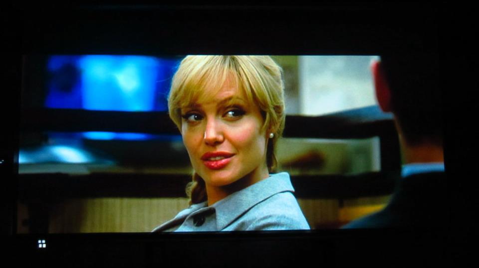

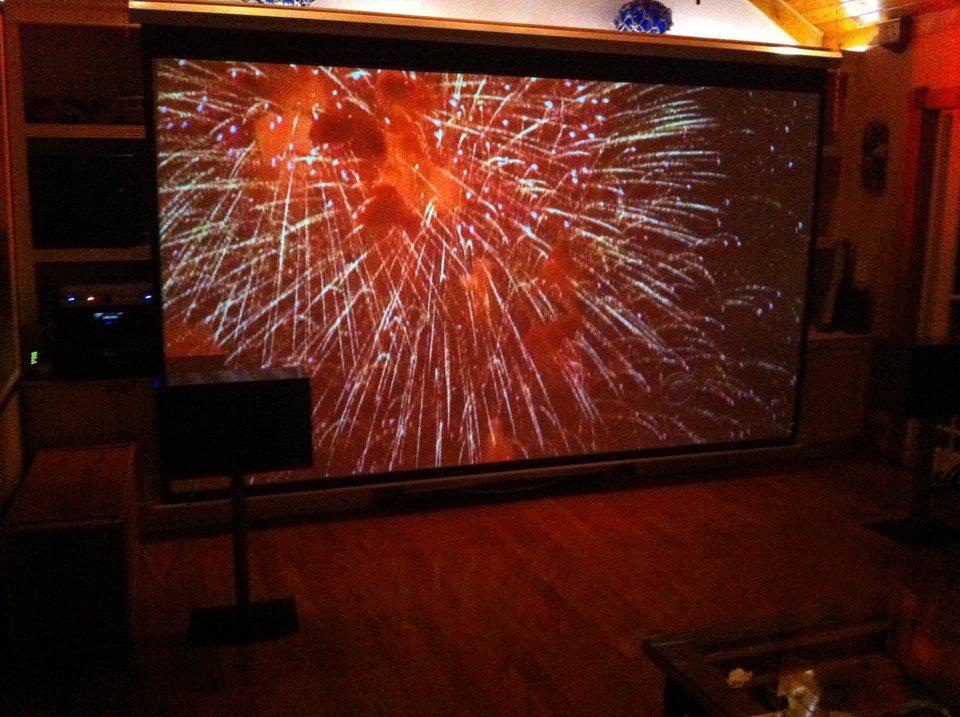

    300405_2351859005392_1517658791_32629116_1031394749_n.jpg298651_2355722141968_1517658791_32631931_1845727775_n.jpg
    I vote for DLP over anything that gives pixellation. The lcd's tend to be whiter, brighter, have screendoor effect and pixel burnouts, and once you notice a burned out color blip, you will be driven crazy by it. I think the newer ones don't have much of a problem. The rainbow effect, I saw once I think, but only once. It's most likely something that you would not have to consider with modern dlp's, as they have almost gotten rid of the effect entirely. The older slower wheels would have the effect when you move your eyes quickly across the screen. The screendoor effect is always pronounced and visible. You will find that sports bars tend to use the lcd's because they are brighter, but for home theater I am sold on the dlp. The dlp colors never fade, never have burnout or burnin problems, don't have artifact problems in the blacks during moving scenes, and are relatively quiet. LCD's are quiet too, but look at the db output in operation because some of the cheaper projectors are pretty dang noisy. My projector is right behind my head on the couch and it is fine. I'm sensitive to room noise, so I turn down the ac during movies and music.
    there are hybrids too, like lycos. I am not familiar with them, but the above advice for research on the projector sites is good advice. I spent three months researching for what I wanted in my budget.
    I don't have lens shift, which is where you shift left and right, but I do have keystone adjustments which do allow you to compensate in case your projector is either left or right of center, or below, etc
    I doubt you need 3d now, or even 1080p for that matter if money is the issue. Most people could not tell the difference as long as you have at least 720p.
    I can't tell a difference between 720p or 1080i
    I'm sure the jump is better with 1080p, but for your budget, you can get a better deal by far not worrying about it.
    If it was that big a deal I would have upgraded by now.
    You can probably find a projector just like mine or better in your budget. I wish I could find a link, but I found a place that had a 150" pull down one gain screen with matting under $200 with free shipping.
    I love the screen. I was happy with a blank wall, really, but then I got a real screen.
    I attached the pictures above just to show that you can have that very setup in your budget. It's not the best, but it is affordable. I showed my living room by day, what it looks like with a dark scene but ambient light, and a dark scene from the side and a scene from the front. Click on the smaller picture to enlarge. Keep in mind, this is an eleven foot wide screen, so the diameter of the screen compared to how they measure tv's, this would be much bigger. It makes a difference if you have the space. I sit back about 15 feet.
    Rock and Roll man, you can do this!!!!!
